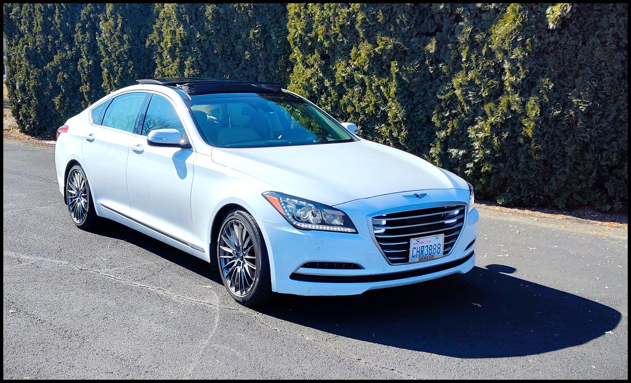

The other bulb gave up (for the turn signals) lasted a few months longer-but this is how my setup looks 'on' I just have the DDs on all the time-received a ticket for running them in purple-WA cops are the worst.
Sorry to hear about the ticket, Rogo. But your setup looks great this way!
Do you just flick a switch to change the color of the lights? If so, or for any other reason you can think of, you should contest the ticket. 👍🏻
Thanks PT, :) It's an app on my phone where I can control the LEDs, RGB strobe and flash, and solid colors. I don't use the obviously illegal settings, but run solid amber or solid purple, and I did contest it :D
What are your lights behind your grille?
