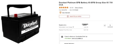

Umm, there is nothing "special" about the battery. I posted it already:
It is a bone-standard Group 65 AGM battery. Not unique at all, in dimensions or performance. But hey, I realize some people will just not accept facts no matter how much proof they're given for for those who choose to willfully ignore what I posted, have at it. What would "this other guy" know about cars?

Please stop asking the parts stores what goes in your car. O'Reilly is WRONG. A 94 series battery is also known as an H7 and while it's the right size, the terminals are backwards.
I did the research. I even posted links to the right battery. All you have to do is find an AutoZone in your area that has it in stock. It's true the parts stores usually won't install interior batteries. If you have to, buy it and have the dealer install it!
