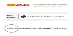

I have a 2022 GV70 3.5T, and I had AutoZone deliver the following battery to my home this morning, and I swapped it out myself in 20-30 minutes - No Problem, good as new!
Does it have the same dimensions as factory battery? Nope
Does it have the same specs as the factory battery? Nope
Does it void the Battery Warranty? Who Cares?
Is it available immediately for $250, and does it work flawlessly? 100%
Duralast Platinum AGM Battery BCI Group Size 65 750 CCA 65-AGM

No parts stores I've seen can match a battery yet to a GV70, and this post originated 2-1/2 years ago. Even Interstate Batteries still points you to a Group H7 (94R) AGM battery, but the post locations are reversed. Like most others that I've checked, AutoZone says there is NO match. Even the parts department of 2 Genesis dealerships said they could NOT tell me the battery Group Number. They only had a part number on a page to order one. That's pretty sad.
