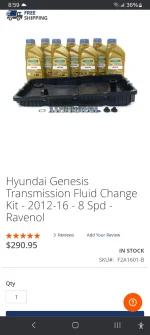

If ur aggressive erase the transmission adaptive programing from the previous owner but first treat ur transmission to a oil and filter change
