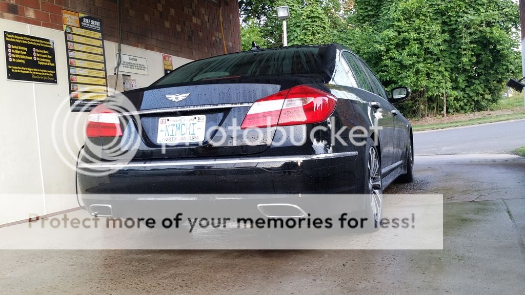

Cell phone pics:
Quick Q: The holes on the 2015 Sedan trunk that are left after removing the H badge...do we need to fill them with something (so they do not have any leaks), before putting the new logo on?
Also, any words of wisdom in terms of positioning the new logo...before I remove the tape for final stick?
Thanks
Looked at some other posts; and used a quick setting clear caulk to seal the holes; and then applied the new badge...rough eyeball, then temp tape, then used a ruler to adjust to line up wrt the bottom lip, and then removed the backing and done.
