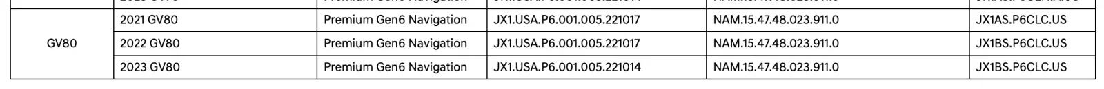

I posted this in another similar thread. I just installed the most recent update and noticed the speed limit indicator in the HUD has disappeared after the update. It is there while the system is starting up, then vanishes.
i did the usb update yesterday and the speed limit is still on the HUD.
my GV80 is a 2021 advanced. looks like the 2023's are have the problems ?
I called Genesis Support on this issue (speed limit on HUD disappeared). They were of no help. They had me contact the vendor they subcontract with, a company called Mapcare. I was told by them there is ANOTHER update coming out next month. All very confusing, not sure why Genesis would promote an update on 10-25-22 when another update is right around the corner. Hopefully this addresses the issue.
At any rate, I did notice the SW versions in the 10-25-22 update are different for 2023 versus 2021-2022. See below.
I wonder if installing the 2022 version on a 2023 would fix the issue?
