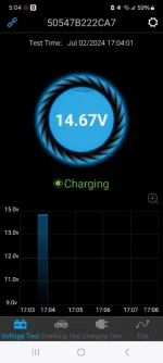

If your battery isn't really cooked, I suspect that after you've had your portable 12V charger on the battery for a few hours you'll be okay to drive your car. I have a battery monitor permanently hooked up to the 12V battery in my eGV70, so I can check the battery's status whenever I'm in close proximity to the car. A little while ago I went out and started my eGV70. With the car ON (in Ready mode), the battery monitor app on my phone indicated the 12V battery was indeed being charged by the car and the charging voltage was 14.67V. I've included a screenshot of that below.

My 12V battery died while my car was at the PPF shop being wrapped and the car would not start. It was there for about 7 days, and when they tried to start it after finishing wrapping it, no go. They tried to charge the battery but the battery would not wake up from dead, as it is not a standard type of 12V battery (AGM or some similar type). PPF guy took out the 12V battery and drove it to the Genesis dealer with a 12V battery from their shop for dealer to fix it. Dealer using what they said was their $8000 charger (versus the PPF shop's $800 charger) was able to revive the 12V battery, no replacement needed, and it has been fine since.
I thought the EV battery was supposed to keep the 12V battery charged at all times, but obviously that is a fail. While at the PPF installer, the EV battery was always showing enough charge to drive the car over 200 km, so that was never an issue. I asked the head technician at the dealership to read the manual with me where it says the 12V battery is kept charged as long as the EV battery is charged, and we both agreed the manual wording was not clear. He said he would contact their tech line and get back to me on the subject, but he never did. I asked the service manager one time if the tech had gotten a reply, and he said not yet and that there are so many requests to their tech line that many queries do not get answered.
Car has been fine since.
My trusty ctek charger wasn’t able to charge the battery. The good news is that it is able to be jump started just like an ICE. At the dealer now.
