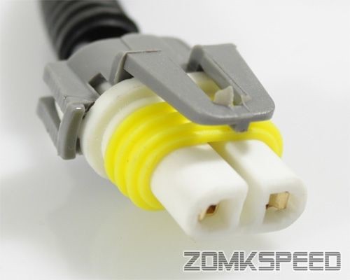

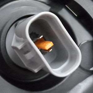

About H11 connector... the latch on the connector is too short for it to click and lock onto fog housing. So witching power and ground wire on your connector wont help. Also make sure you get the right type of H11 connector. Like the one I ordered which has space between 2 "prongs" so that orange tip can go in. Check page 14 for those parts I ordered.

Thanks for info Lou. Found out, as you indicated, that latch is too short to connect -- after spending an hour with Dremel tool grinding it down to slide into latch groove. H-11 connector does fit, but seal is way too thick to slide into lamp connector. Replacing it with a couple of turns of electric tape should provide an adequate seal and tight connection.
