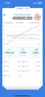

Gelashvilli performance tune. Thank me later. Geptuned.com I'm running his e85 tune and the car has trapped 116mph in the quarter mile. 0-60 is almost 3 seconds
