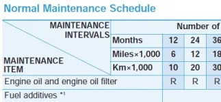

^ so you are referring to the Severe Maintenance schedule, not the Normal Maintenance Schedule. that brings up a good question: what evidence do you need to show to prove you qualify for the Severe service plan? clearly most guys on the forum do not qualify for this service plan. also, it seems many guys in the US are not getting full synthetic included as part of their service. dealers are using either dino or blend oils - and done at 6k miles. so for those reasons, guys like myself (i'm in CAD) are more comfortable with OCI's at twice the Normal Service frequency - which is essentially what you are getting.

Normal:
Severe:
