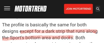

Hmm, here's a bit of a contrary benchmark
I had just recently noticed the extent of this on the Standard Model (subtle). (Standard Door trim is chrome, even though it looks dark in photo).
