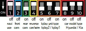

Rememember dipswitch 4 for CAN, these are the settings I used for Genesis.

dip Switch settings,
1 OFF 2 OFF 3 ON 4 OFF 5 ON 6 OFF 7 ON 8 ON 9 OFF 10 OFF

I think the dip switch setting is ok.
