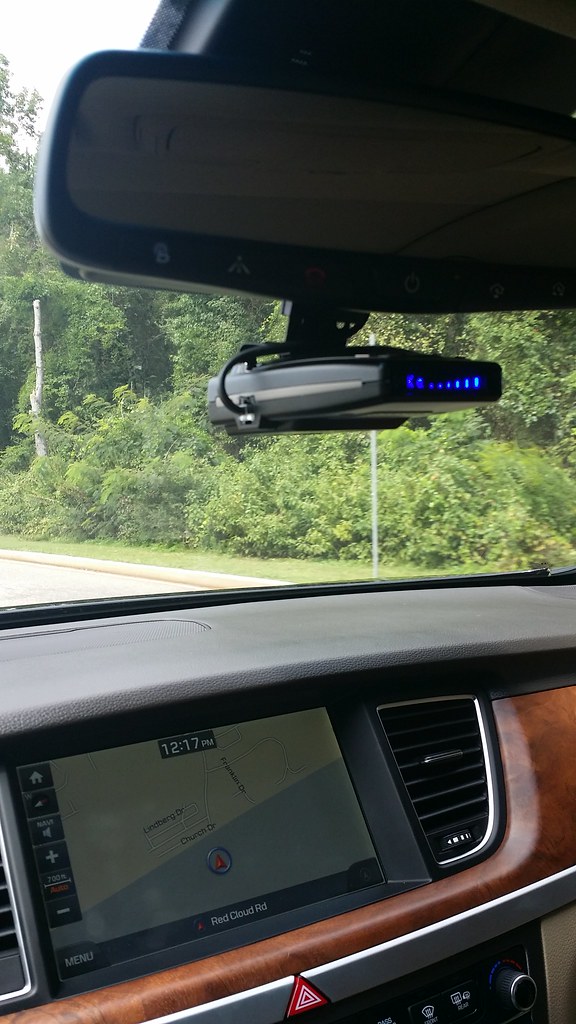

MisterTmac, I just want to thank you very much for your helpful illustrated post. I have hard wired my radar detector several times to the mirror in various vehicles, but the 2015 Genesis is the first one that effectively hid the wiring harness. I searched the internet high and low, and finally found your post. It was the only source that showed a) where the wiring harness was, and b) how to get to it by simply popping off the little plastic cover behind the mirror, and c) which slots to use for the wire connections. With that information it was relatively straightforward to install my Passport 9500ix in my new Genesis 3.8 RWD (which I am loving). THANKS AGAIN!!

my Escort Solo is up and running.

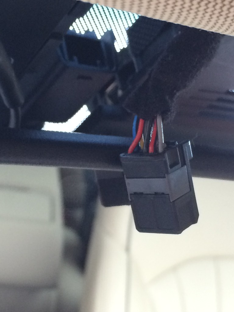

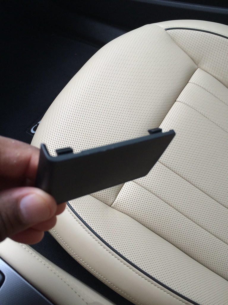

Cover to remove.. small rectangular piece, simply angle mirror down and "pop' it out.
Cover for mirror connector by T McCoy, on Flickr
I used the Grey (+) for switched power with cars accessory, and the black (-) for ground. I used the Blendmount mirror tap (Nano size)
Miror connector by T McCoy, on Flickr

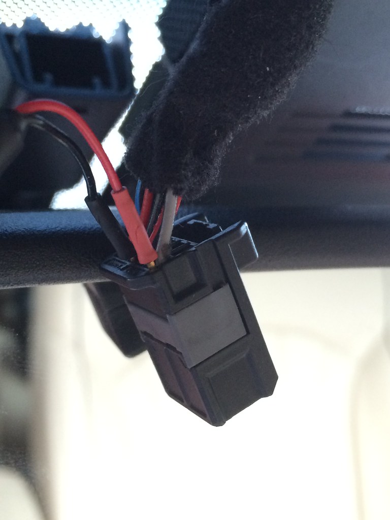

I stuck the wiretap leads into the grey (+) and black (-) wires.
I also used the supplied zip tie to secure the wire about 1/4" up from the connection. Also used needle nose pliers to get the wire taps in a bit more..

This walk-through was extremely helpful. I installed my mirror tap in less than 5 minutes with ease. Hardest part surprisingly was securing the tiny zip ties around the wires.
