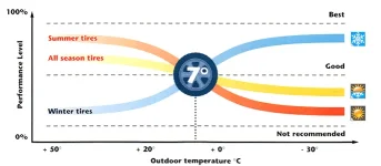

As you may know the rubber on the snow tires are softer than all season tires subjecting them to accelerated wear if driven in hotter 90 degree temps.
The rubber on 'snow' tires will wear faster at temps well below 90F.
