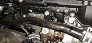

First thing I did was focus on removing the coolant lines feeding the turbo. My low-pro hex wrench did the trick, and the bolts are out. Next, I unbolted the coolant line bracket, then unclamped the front end of the hose, here....
Upon disconnecting the hose I got a nice flow of coolant coming out, spilling to the ground. I knew this would happen at some point, because after draining the radiator there is always still plenty of coolant in the block. After the fact I realized I should have disconnected the hose further down the line where it plugs into the water-to-oil cooler located on the oil filter housing, then just allowed the coolant to drain into my container. Obviously my lack of sleep is getting to me.
Anyway, the turbo coolant line is disconnected, mostly. I left the hose connected on the back of the block, and tied the hose to stay out of the way...

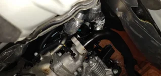

Next up is the lower radiator hose. First I unbolted the bracket, just above the turbo.
Next, it looks like there is another bracket + bolt on the back of the block. It was easiest for me to undo this from underneath the car...

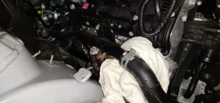

Now ready to unclamp the hose from the metal tube...

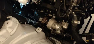

Again, I had a little bit of coolant leaking out from where the metal tube connects to the back of the block, this was because of me angling the tube upwards to get out of the way. By now I can really see that little turbo in all it's glory!

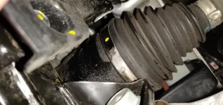

And that's where it stands right now. I'm too tired to continue working, as I'm already making mistakes. Anyway, the next challenge is unbolting the turbo oil lines. The feed line is bolted on top of the turbo (as seen in the picture above), and the drain line is bolted up underneath the turbo. This will be a problem for me, as the drain line looks very difficult to get to. Here is a pic of the drain line, used my phone to sneak up underneath it...
And here is the view from underneath the car....Haha. I've got a big front differential and passenger's side axle in the way.
The guy on the Stinger forum who did this told me it's best to unbolt it from underneath the car, using a very long extension. I am beginning to wonder if he has a RWD car, and subsequently has much easier access to the turbo from underneath, whereas I have my AWD drivetrain blocking the way. That said, I need some time to think it over. Despite the stuff in the way, there still might be enough room to do it - but it will have to wait for another day. For now it's time to sleep.

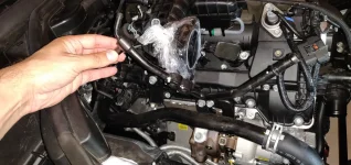

You know, at this point it may be worth just trying to tap it where it is. Now that the coolant lines are out of the way there is a ton more room. Maybe I should rent a tap and give it a shot... If it works, then I wouldn't even have to pull the whole turbo.

Well the old broken stud is already out, the dealership at least was able to do that themselves, so they weren't completely useless.
I looked at all the threads with my phone and they are pretty much all intact, but a couple do look a little rough. I'm hoping I can just chase those threads down with a tap...

I'm trying to better understand the situation. Sorry if I'm being thick. The dealer got the broken stud out, right? So why do you need to tap it? To clean up the threads, or is it damaged or is part of the stud still stuck in there?

The threads on the turbo exhaust flange are still intact, but some of them little just a little galled up. I would use the tap to just clean up the existing threads.
Got it. Of course, they may grip better as is. 😉
