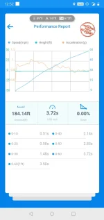

I'm AWD as well. Sport mode, TC, SC off.
Slow down to almost stopped, let off the brake while pulling up and keeping the e-brake held. The car will kinda lock into a stop. While holding the e-brake up, give it 3/4 gas for 1 second and then let off the e-brake and roll into the gas. Your launch will be much better.
Then use the shift points @Toddasaurus gave you.
I did this because this is the kind of leadership America needs right now...
Not using brake snip, either.
^ that’s awesome. You beat me now as well. I think I was at 3.78 or 3.79.
Imagine with brake snip. 3.6 probably.
@Toddasaurus
Nice job! I posted a new PR as well. LC using 2nd gear. I'm just losing too much traction in first.
BAM! Nice work man. Some serious pull in that Santiago Silver AWD G70... Now the rest of you wish you had the same spec... (y)
Also, I had 3/4 tank of gas, and my WMI tank was full (2.25 gallons).
I have no doubt I could get into low 3.6's, and probably even high 3.5's using brake snip.
Mighty impressive Todd! I guess the larger intercooler and the WMI got your time down from an already impressive time of 3.9.
The quarter mile or 0-100 time would be interesting, but understandably harder to test/measure safely.
