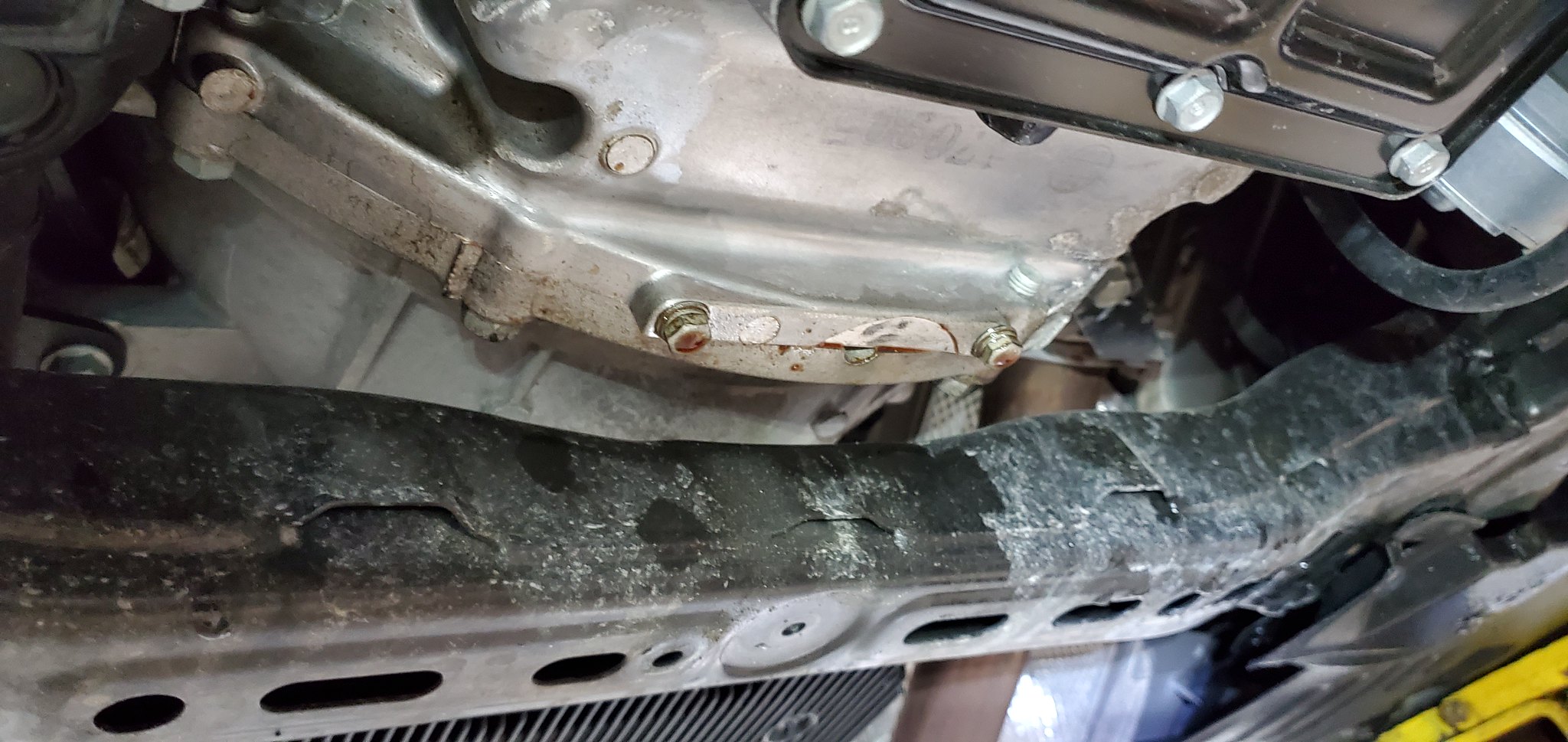

I STRONGLY recommend EVERYONE to inspect the bell housing on their car for leaking. Seriously. Do it ASAP. I have a feeling this is either a design flaw, or a significant quality control issue on our cars. If so, Genesis needs to know.

@Toddasaurus Is this an easy check? I'll do it tonight if it's simple....

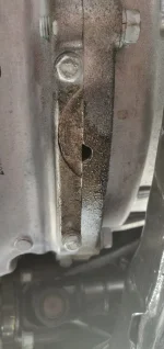

It's simple. Put your car on ramps, or jackstands, remove the rear bottom engine cover (6 bolts holding it on, and one plastic clip), and you'll be able to see the bellhousing very clearly.
Yeah, that is simple. I'll muster up the energy to have a look soon. Would be good for lots of us to check and see how wide spread it is.. Maybe it only effects a range of serial numbers... who knows.
Yup. That's leaking.
Todd, this looks almost the same as I had in mine. Was there any oil on the undercover? I am guessing not. Maybe clean and check the area again in a few thousand miles / next oil change. You still must have lots of mileage/time to claim warranty (if they honor it that is). If it does not turn into a major leak like the others are having, then maybe drive it for a year or two and trade it in? I am on the fence on this regarding mine.
Without looking at my car, what is the short term and long term risk for this leak? Is it something that can continue for a long time as long as fluid is monitored regularly? Does it impend catastrophe? Is there a risk of dust and other foreign material entering the transmission? Can it be ignored? The leaks I see photographed are a small amount of fluid.
