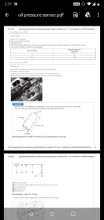

I mentioned it to my service manager and he wondered if it may be similar to an issue with the Hyundai 3.5 litre motors. The oil pressure switch leaks into the valley between the cylinders and then runs out of a weep hole that comes out between the engine and transmission. Often misdiagnosed as a rear main seal. Very minor problem that looks like something much more serious.
This guy explains it very well.
Interesting. The 3.3tt has the sensor in the same location. I never removed the intake manifold runners to check the valley for any oil, though.
Even so, @Van_Nik_75 evidently had a bad rear main seal. It would have been clear where the oil leak was coming from after the engine and tranny were separated.
