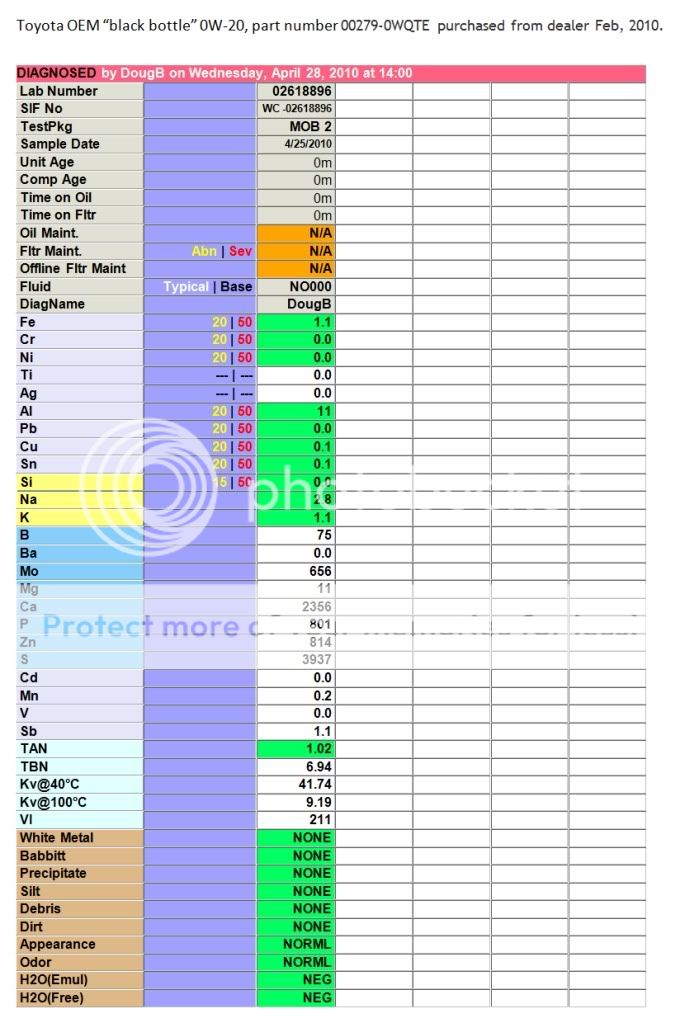

Once again, you have strayed from the original dispute. You were claiming that Mobil Super and TGMO were the same oil, and I explained that they are not. If you want to believe that they are the same oil, so be it. As I said a few posts back, quote me where I explicitly state one oil is better than the other. When you do that, I will go away.
And just for good measure, I will post more VOAs from BITOG. It is a long-shot to believe that people are falsifying VOAs over there.
Taken from here: http://www.bobistheoilguy.com/forums/ubbthreads.php?ubb=showflat&Number=1829467&page=all
And a second VOA on the first page, post one:
http://www.bobistheoilguy.com/forums/ubbthreads.php?ubb=showflat&Number=1919589&page=1

Additionally, when looking at an oil, one must take in to consideration the oil as a whole and not look simply at one attribute.
