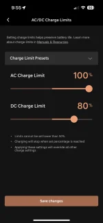

Updating AC limit in the app does not work anymore for me. I was trying to update to 100% for a long road trip and it just didn’t take no matter how times I tried (and false positives “updated successfully).
I have the same experience in the app. Can only adjust in car. Reported to Genesis Customer Care.
I was able to update to 100% on Friday night, and it successfully changed to 90% tonight.
Similar note here, I really wish there was a way to tell the car to do a one time charge to 100% from the app, and even better would be to tie this to a departure time so you tell the car you are leaving at like 8am tomorrow morning, try to charge it to 100% so it completes maybe 15-30 minutes before departure.
Unless I'm mistaken, we can do that on the Canadian app.
Mine still doesn’t change.
I'll admit I have not used the app all that much since it is not "my" car. I can't imagine the apps being that much different, so how do you do it? I looked at it Friday night for 10 minutes and it was not immediately obvious to me.

In the Canadian app:
  1. Go into 'schedule'. Use the slider to turn Schedule on.
  2. Select Schedule 1 or 2, then enable Scheduled Charge
  3. Set the day and time you want to depart.
  4. Make sure you select 'Apply' or 'Save' before hitting the back arrow on any changes you make anywhere in the app, or it will just ignore your recent input - without warning.
  5. Go back to the main 'Schedule" screen.
  6. Use the slider to turn on 'Intelligent Charge'. You'll then need to input your 'Off-peak hours'.
  7. You want to set this so your off-peak period ends when you want the car to be ready, so if you're leaving at 8AM, select that as the end time.
  8. Do some math to estimate how much time you're going to need to charge, and set the start of your off-peak period so that the total time within the window just barely covers what you'll need - maybe is even a hair less. For example, if you need 3 hours, set off-peak for 5 - 8 AM.
  9. Select 'Prioritize off-peak charging', this will cause the car to charge mostly during the time you specified, but gives it permission to start earlier, if needed, to complete charging by 8AM. If you tell it to charge ONLY during the period, you'll get your three hours of charging, and that will be it, even if that doesn't get you to your desired charge level at departure.
  10. Go to 'Target state of charge', and select the percentage you want the battery to be at when you depart. 100%, if you want to leave with a full battery.
  11. ALWAYS HIT SAVE/APPLY WHENEVER IT APPEARS ON ANY PAGE THAT YOU'VE MADE A CHANGE. Otherwise, you've just wasted your time and the car won't be ready.
There you go, 11 simple steps. :)
