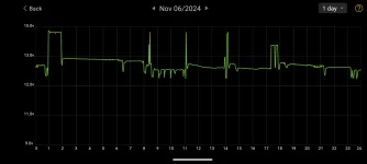

This is the voltage vs time for yesterday. It wasn't plugged in overnight but it charged the battery from 1 to 2am. The sharp spikes at 8-something, 11am, and 2pm were short drives to/from work. The double-bump between 5 and 6pm was a 15 minute drive to pick up dinner and an 11 minute drive home.
I don't know why it's sometimes steady between drives/vehicle-off-charging and other times there are episodic dips. I could see a dip when the a/c does the drying thing but not sure why they repeat sometimes.
