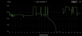

I think the post-charging factor may be coincidence. I had this happen once while connected to the EVSE and three times when not. First two times I suspected the OBD-II dongle I forgot to unplug. This last time, no OBD-II dongle.
The two peaks before the drain were 3-minute drives to and from lunch.

I’ve had my car for 3 weeks and it is in the shop for the second time for a dead 12v. What happened at your appointment? They found I have a bad part causing a slow drain. (I have no idea what they called it just a bunch of letters). It is back ordered with zero timeline. Also they are out of lenders so I have a freaking gas hog from Enterprise 🙄🤬
I did some research and these letters sound familiar and the issue too. It is the ICCU. Just so happens there was a 145k recall on the part for all 23-24 gv60’s the last week of January 🙄. It sounds like the new ICCUs were not put in all of the already build 2025 models. There is no official recall for 2025 but it sounds like it is coming🤬. That is why the part is on back order they are busy replacing all of them on the 23-24 models. It could be months before I get my car back. Thanks Korea! So no reason to do the collateral swap. Another 2925 will just have the same problem😢
