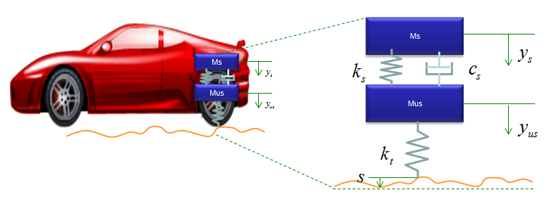

BTW, the "floaty feel" at hwy speeds is because of the undersprung springs and shocks. Larger wheels/tires are not going to help with that much. In fact, they might exacerbate the problem. A suspension system is essentially an unsprung mass (Mus) attached to the sprung mass (Ms), via a spring (with spring constant ks) and a shock absorber (with damping factor Cs).
Problem with the OEM suspension tuning, is that in order to run 19" tires with very low profiles (very stiff tire spring constant, Kt), and still have a reasonably comfortable ride quality, the factory suspension has rather soft spring rate ks and damping factor Cs. This is where that "floaty feel" comes from.
Stiffing the tire spring constant even more (with even lower profile tires) is NOT going to reduce that floaty feel. Instead, it is just going to transmit more of the road undulation, s, up into the suspension system, and taxing Ks and Cs even more. The result is more uncontrolled suspension articulation, yus, and in turn, more body movement, ys. That is... even more floaty feel.
What's worse, less tire compliance, due to reduced kt, means the tire will be less able to absorb road undulation, s. So, over rougher roads, your larger tires will end up not sticking to the road surface as well as a higher-profile tire. So less mechanical grip.
