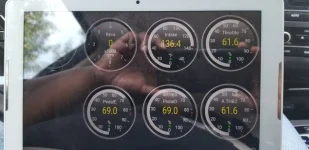

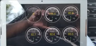

I used my Torque app to see what the pedal and throttle were registering with and without the KD Switch engaged. The car was "on" but not running. Sorry, the Torque app only let me see the percentage the pedal was pressed, and the percentage the throttled was opened, not the voltages.
Pressed all the way down without triggering the kick down switch says the gas pedal is at 69% and the throttle is 61.6% open.
Pressed all the way down, this time engaging the kick down switch, the pedal registers 82.7% and the throttle is 85.5% open.
The results were the same with and without the sprint booster. I tried pressing the pedal all the way down then slack off to release the kd switch, and visa-versa. The percentages were the same, and I could not hit any number in between. It jumps straight from 61% to 85%. Taking this data into consideration, I would guess that that last click of the pedal also triggers W.O.T.
So, it looks like the most the throttle will open without triggering the kick down is 61.6%, and 85.5% when engaging the kick down. It'd be awesome if someone else could confirm these number on their car.
