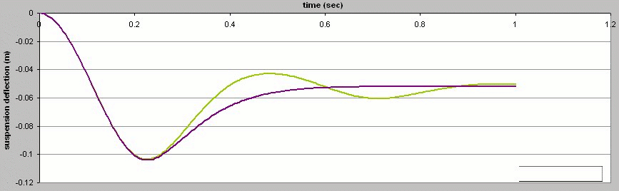

Any spring and mass has a resonance...actual several (and 1st order, 2nd order...etc.), where inputs at a frequency will cause greater and greater amplitude.
http://hyperphysics.phy-astr.gsu.edu/hbase/shm2.html
http://en.wikipedia.org/wiki/Harmonic_oscillator
http://en.wikipedia.org/wiki/Vibration
This can happen if the slow damping is insufficient...or if there is not enough rebound damping in general. Lightening the springs will help with the stiffness, but might actually move the resonance into a worse range. The Genesis might be better served with tuning both...the spring rate and the damping.
http://www.ast-usa.com/resources/Critical-Damping.pdf
http://www.shock-shop.com/Thoughts%20on%20Damping/Shock%20Tuning.htm
From this source. http://shimrestackor.com/Physics/Spring_Mass_Damper/spring_mass_damper.htm
"Under damped suspension response zeta<1:
If the suspension is under damped (z< 1) the suspension will oscillate and baby buggy a couple of times before settling down on top of the step. While this is an intuitive result it is important to note that the equations duplicate this behavior. In addition the equations give you an exact numerical description of the process. For a damping coefficient of 0.2 (z=0.2) the suspension will overshoot the 10" bump by about 5", then undershoot by 3" and baby buggy a couple more times before setting down on top of the step. All of this motion occurs within 1.2 seconds of hitting the bump. As the value of the damping coefficient (z) increases the overshoot decreases as well as the number of baby buggy oscillations and the time required to damp the system."
http://www.se-r.net/suspension/shock_tech.html
"Today, street performance shocks have rebound damping rates that are two or more times greater than compression damping rates. The single action of adjusting bleed to affect bump and rebound is, by definition, a 50/50-style change, so the overall damping proportion will change as more bleed is dialed in. Independent adjustments allow the alteration of one characteristic while not affecting the other; this is therefore more precision and involves less compromise."
http://en.lfsmanual.net/wiki/Advanced_Setup_Guide
" The critical damping is the strength of the rebound damping needed to stop suspension movement the quickest after motion has started."
