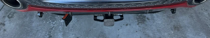

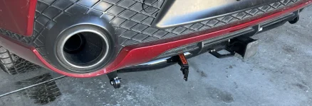

Genesis accessories has them now. They're $680 with the light harness, and $500 just for the hitch. I installed mine at a uHaul for $150, since the dealer was unavailable in a timely manner and this was not a big job.
There almost looks like a hinge point on the left and right side. A bolt seems to attach them. Any idea what this is about?

End result:
It looks like there are 3 bolts on each side that would allow the horizontal section to be easily removed. Is that true? Can the horizontal bar easily removed and reinstalled?

It wouldn't be difficult to remove and reinstall. I think the exhaust hangers would be ok to leave in place. However, there is a specific tightening sequence. I think it would be difficult to reinstall unless you loosen the bolts that hold the brackets to the frame of the vehicle. When tight, the crossbar is compressed and you would have a hard time getting it back on. If you were to loosen the bolts holding the cross bar to the bracket, you'd need to use some force to get the bar out, then loosen the bolts to the frame to squeeze it back in, then tighten everything in sequence back to specified torque.
My concern would be if you were to do this frequently, you may cause some issues with the bolts welded into the vehicle chassis. If you were to strip those out, it would be a tough $$$ fix.
