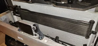

Other than maybe a thermostat, can’t imagine anything being internal to the transmission cooler? If over temp related, seems the ECU would pick up on that and throw an engine code? Under normal driving can’t figure the transmission getting all that hot? I read somewhere our engines have an electronic thermostat fully controlled by the ECU and not a conventional one that is heat controlled with no computer. Not sure if the transmission cooler lines and the engine coolant hoses all see the same temps and are tied together, or independently controlled somehow?
Afyer some research on the interweb, it seems as though the internal core is cracking at the seams of the tubes inside the cooler allowing the coolant and oil to mix creating a sludge that eventually clogs things up within the transmission and even the engine internals where the shared coolant passes through the jackets. It makes a real mess apparently.

Is this a water cooled transmission oil cooler? All the oil coolers I've seen were air cooled, like a normal radiator.
Not good at all. I have not poked around under the hood yet to see if we have a transmission dip stick or not? If a contamination gets in the transmission fluid if would show up on the dip stick. A external tranny cooler would have mitigated co-mingling of fluids vs borrowing from the engine radiator. Newer cars these days seem to not have ways to even re-fill tranny fluid for manufacturers don’t won’t us touching the tranny.

The engine oil cooler, on the other hand, is a water-to-oil separator. It's that block that the oil filter attaches to. It is object A in the bottom picture of this page from the FSM...
It is the metal portion that the oil filter housing attaches to. This is where oil and coolant equalize temperature relative to each other. These types of coolers can definitely fail, at least in older cars I've worked on. But if this thing is failing I doubt you'd have shifting problems...
