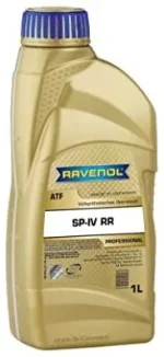

You can get the genuine Hyundai SP-IV RR, or you can get a cheaper alternative that still meets the same spec. I don't know if they're really any different, or if it matters.
Here is a brand that meets the SP-IV RR specs. I think it's a bit cheaper than OEM Hyundai ATF, but I can't remember what I spent on it at the dealer.
Amazon.com: RAVENOL J1D2197-001-999 SP-IV RR ATF Automatic Transmission Fluid (1 Liter): Automotive
