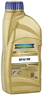

I drained my transmission fluid last summer, replaced with OEM fluid. It's EXPENSIVE, but there is another, less expensive option that supposedly fulfills the same qualifications as the OEM fluid. Even so, I didn't even want to take that risk.
When I drain my ATF again I'll also be replacing the oil pan, as it has a filter built into it. I might consider trying this other one, but I'm not sure...
Either way, I think swapping out fluid more often than what the manual recommends is a good thing. Also, when you drain it, you'll get 4 quarts out at most - but the tranny holds about 10 total. That said, when you drain it you're only doing part of it, thus the idea that changing more often is a good thing.

Operation was exactly the same after draining/refilling the ATF. Some dealerships may have the ability to completely flush the transmission, but it requires some special equipment to do so.
Edit: I'm sure most transmission specialty shops could fully flush the ATF no problem. If you went to one of them, I'd just make sure they use SP-IV RR specific fluid.

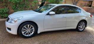

My Infiniti G37 did this exact same thing. Felt like down shifting a stick. Infiniti had an updated PCM program that once reflashed problem was fixed. Can’t help but think do all our G70s have the same revision of what is loaded to the PCM or are there newer revisions? Seems the dealer could plug into the OBDII and find that out quickly. My 2020 has had that hard downshift once in a blue moon. I also wait a minute or so when starting to warm things up.
This has only happened to me twice in one day back in Nov 2019 and has not happened since. Maybe all the WOT I've been doing fixed it, not sure.
Dec 2018 build date, 3.3T RWD.
So did my G37. I read somewhere that they programmed the tranny to do this, to simulate a stick shift. I thought it was kinda weird but it didn't bother me much. I could take my foot off the gas approaching a red light, and not hit the brake until I was going less than 5 mph. It had tremendous engine braking. I think it was the rev matching that made it more present.
Correct on all counts. The G37 was always ready to launch with the rev matching. Just felt strange to have a automatic car you could feel downshift. After my re-program, still a little rev matching existed but felt much better. Went 8+ years in that car with no issues so nothing bad to say about Infiniti.
Me either! Got 10 years on my 2009, only about 83k miles - loved that car, was the Journey Sedan RWD. Sold it for $9,250 in Nov 19 and bought my G80.
