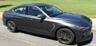

Installed my winter wheels/tires last night...
18" wheels look tiny on this car IMO.
Man, those rims looks sick on the car :cool:. Detailed specs and model numbers could help other buyers hunting for the wheels.
Yes, they will look a little tiny since all of us are used to seeing those 19" Rims on the car and downsizing by 1". But I am sure that you will get over it after few weeks.
