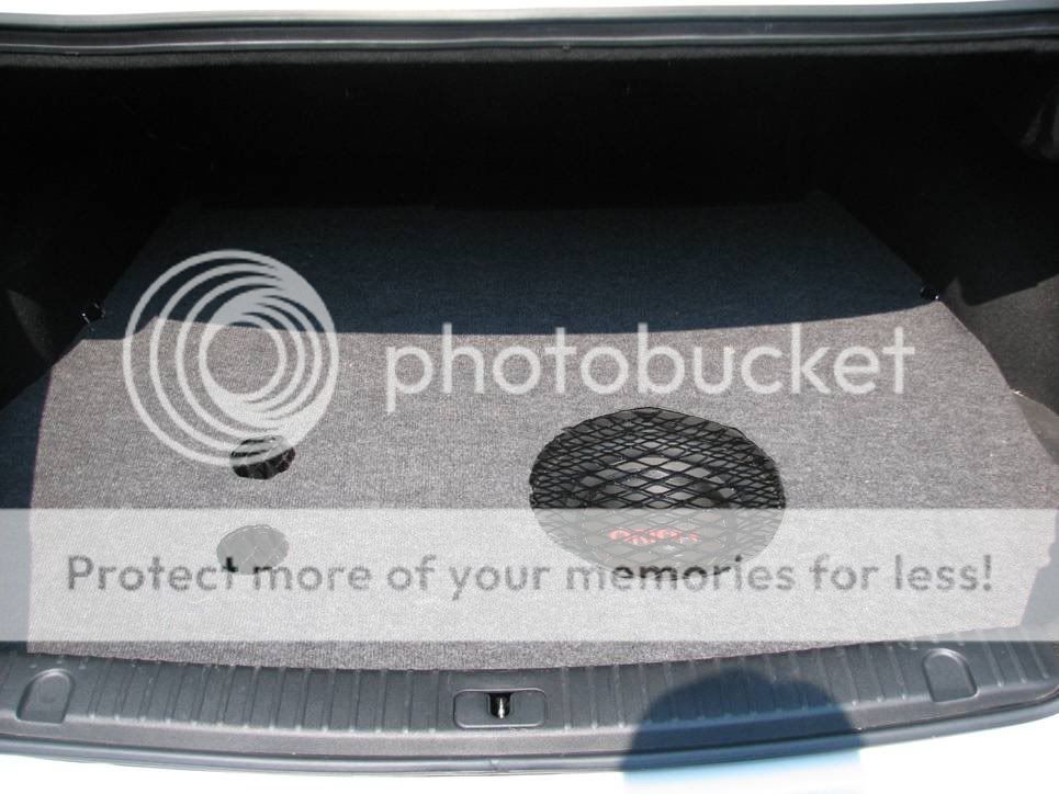

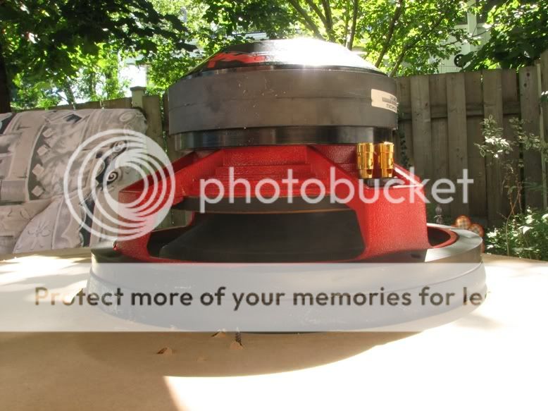

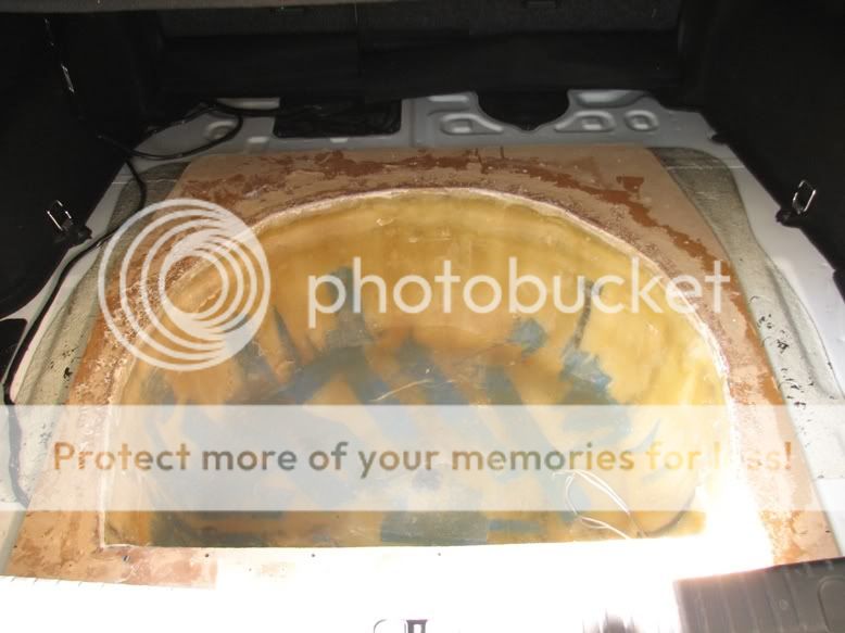

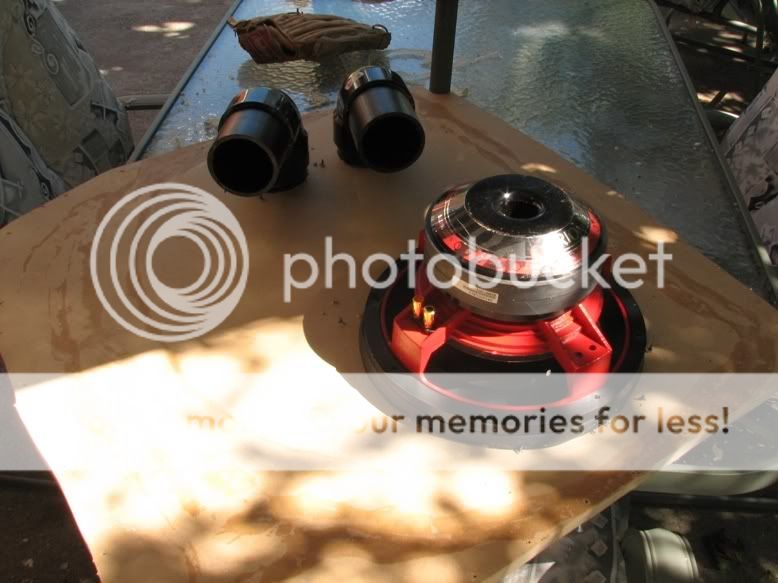

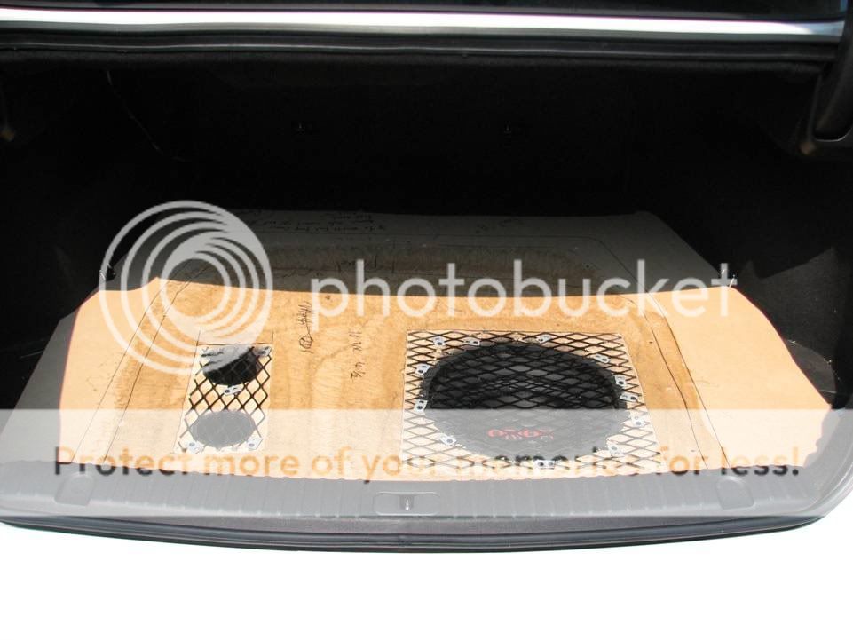

Here's what I had done with my current Azera as soon as I got it.
This is where the spare tire was...
This is the sub that I installed...
This is what the back of the board looked like
Once the board was installed
and finally when I installed the carpet over it...
I can assure you that it makes a MAJOR difference in the sound output...

Most interesting. The volume of the spare enclosure would in fact work nicely to resonate the sub freqs. Technically, the idea is that the enclosure is not supposed to move in any way. Its job is to reflect all waves forward, pushing the driver forward into the free air (and yes, out the ports) In this design, you're allowing the low freqs to resonate in the cavity thus transferring the vibration into the car frame. I'm sure you're right that it is awesome, especially in the seat :)
I gotta say--- the closeup pic of the sub... with the fence in the background... it LOOKED about 4 feet tall!!!

1. Did you calculate the ports (length, volume, etc.) or was it a SWAG?
2. What's the plan for the 'flat day'? Guessing that you thuroughly thought it through.
3. How does it sound with groceries on top? (the family thing...)
Yes...it came out to 3.1cu.ft and the frequency was calculated for 32HZ

This was the biggest surprise to me. Every year we go on camping trips and we pack the car pretty good...I was really surprised how much bass was still been delivered despite the trunk being full. The trick is NOT to block the ports!
To me it beats the hell out of putting a box in the trunk that takes so much room. I'll never do that again. And you're right that it resonates even more because it is part of the car that way. I can assure you that my car vibrates a hell of alot without delivering 1000's of watts.
