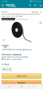

Here is the fix I did to mine... I had initially tried some honda shin etsu grease around the seals, it didn't work. Saw the post by Revvdmedia about the stinger sunroof rattle fix and tried something similar.
There is a notch on both sides of the tracks that the sunroof goes into, this is towards the front of the sunroof opening right behind the windscreen. In the picture below, I believe the stinger forums mentioned putting something down in the area I circled in blue, instead I ended up using some foam tape (pic below) and stuck it in the area I circled in red (after cleaning it really good with rubbing alcohol). No more rattling ever since. Hope it works for some of you.
I think this fix should work for some people. It makes a lot of sense, especially on a car with symptoms like mine. When it's noisy, it's only when the sunroof glass is totally down (pretty bad) or tilted open (even worse). There is a "foot" on the bottom of the sunroof glass that looks like it sits in this notch (on both sides). Both the "foot" and the "notch" are hard surfaces, both metal, or metal/plastic with no barrier between. It's probably noisy because the contact between the two when it's parked closed, and probably even worse tilted because the foot and notch probably have slightly less pressure against each other, causing even louder more annoying noises. Making the glass slide open takes these two surfaces away from each other, noises go away.
As for why this seems to go away when it is cold, that has been stumping me but I have a bit of a theory now. Right now when it is rather cold, with the glass fully closed, it's almost totally noise free. When I tilt it open, there are still some noises, but less than when it is warm, but still pretty noticeable. Being heat related, what is expanding when it is warm? My original thought was maybe something with the tracks since you can feel the metal of the track does heat up with the sun. My latest theory has to do with all the seals. I'm thinking maybe the rubber of all the seals contracts when it is cold. Maybe this is causing the roof to close tighter, against the notch, reducing the noises substantially. When it warms up, all the seals expand, causing a very minute gap between the foot and the notch and going over imperfections in the road causes contact between the two and rattles.
Anyway, that's all I have on that topic for now. I'll admit there are a lot of parts in that assembly, so who knows.
I would think the seal elasticity could be affected with temp changes. Warm weather generally makes seals softer and more pliable, where cool weather would be more firm. Adding some foam tape in the areas noted sounds promising. I’m hoping 2020 models might not have issues but am not holding my breath. I already have several foam tapes from other projects as well as access to some really good aircraft fuel tank sealant that can provide a really durable rubber coating in an area if the foam tape seems to do the trick. Can’t believe Genesis can’t do a redesign as needed to solve the issue for good.

I can say with certainty that the fix I applied previously works. Yesterday I removed the foam tape and the rattle returned. Reapplied it and rattle was gone.
