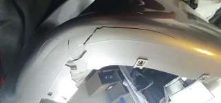

^ i like your ramp set up. props for the rubber mat underneath to prevent slipping. i learned that the hard way a couple weeks ago. i was pulling my E39 540i/6 up on ramps to take a look at a small leak. my plastic ramps have rubber pads on the bottom and i've used them many times with no issues. that changed. just as i was nearing the top of the ramp they both slid out and my bumper hammered down, cracking the bottom/undersides. the extra fun part is i had just had the bumper refinished and painted.
so, now i have a new project that i didn't need. multiple bodyshops said i'd need a new bumper cover and they didn't want to touch a repair. but at ~$1100 i said no bueno, and i'll fix it myself even though i've never attempted real bodywork repairs before. but how hard could it be? i've already done the structural repairs and am prepping for paint and clearcoat.
Ouch! Sorry to hear that. Nice DIY repair job though. Did you lay some fiberglass cloth in there?
