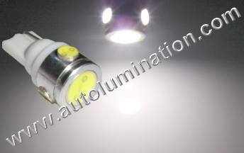

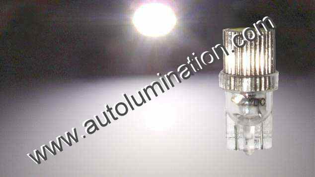

I tried installing 2 bulbs from www.autolumination.com
Item #: 194 168 W5W 2825 Supernova Bulbs With Metal Heat Sink (Superwhite).
Installed the first one, after a couple minutes it started blinking then after installing the 2nd one that one started binking. These were brand new bulbs and both are bad or not the rights ones for the "position" lights.:(
Will be trying some new bulbs in a couple of weeks. I have two different ones to use if the first set does not work again!
The new bulbs I am going try are from the same vendor. I think "scottdk" used them with great success.
Item #:194 Superstar Bulbs With Metal Heat Sink (Superwhite).

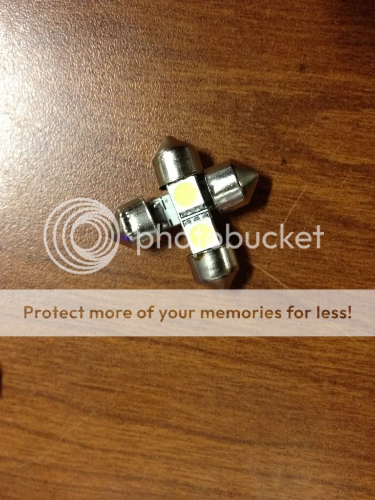

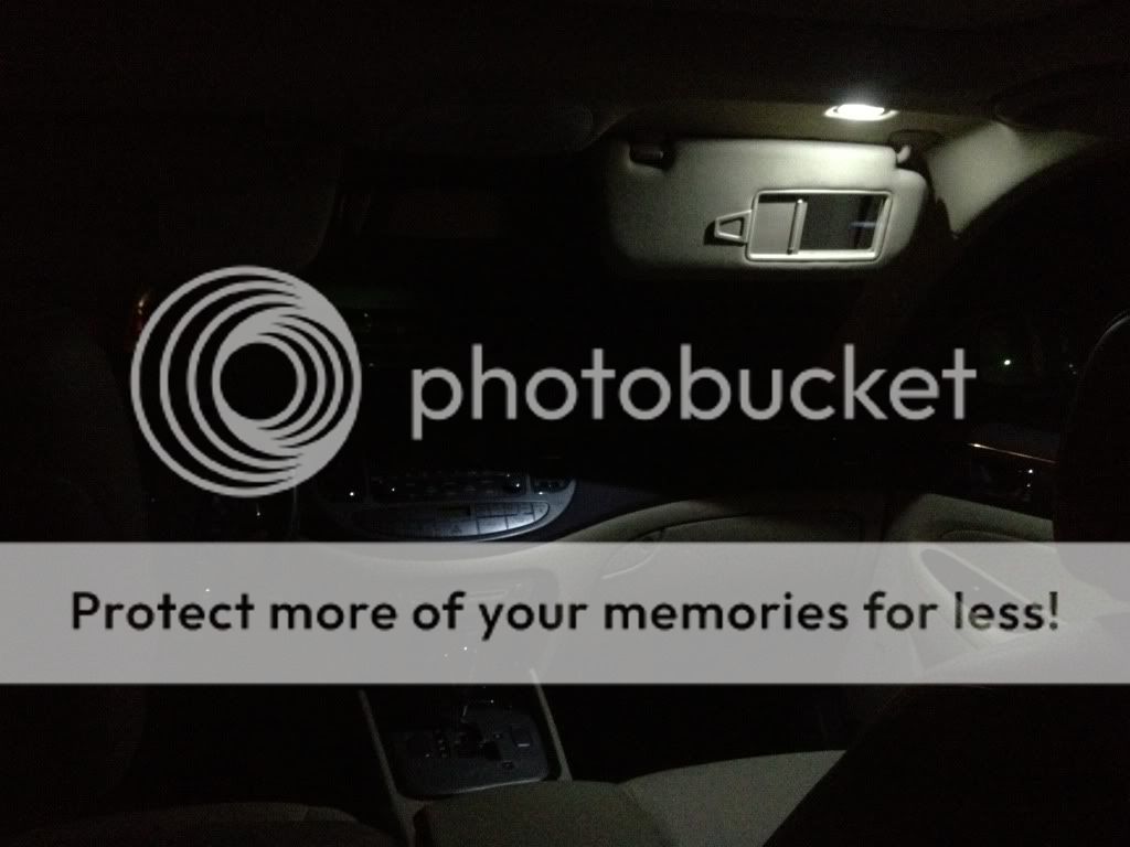

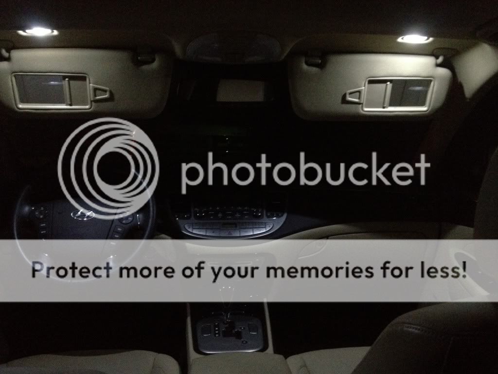

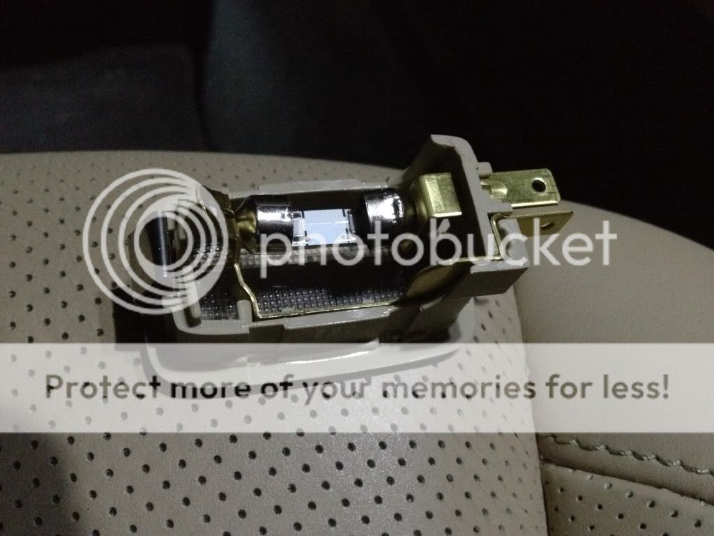

Below is how I modified my 31mm 2-5055 festoon bulbs to fit in vanity mirror. Cracked outer plastic housing and resoldered each end cap closer to the board, reducing overall length of the bulb. I was unable to get the bulbs to fit by modifying the contacts inside the bulb housing like is possible in the trunk.
Pics Below...
Original bulb on top
then modified LED
unmodified 31mm LED
You can see there is no way the 31MM would fit

Thanks for those helpful comparison pics...if u have no issues looks like that will work out well for u. Others might entertain a 27.8mm approx festoon 6smd panel

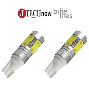

I was wondering if these will work to replace marker light bulbs inside high beam reflector?
[ame="http://www.amazon.com/Jtech-7-5W-Power-Xenon-White/dp/B007I75D8W"]Jtech 2 x T10/T15 7.5W High Power SMD LED Bulb Xenon White. Pair : Amazon.com : Automotive[/ame]
