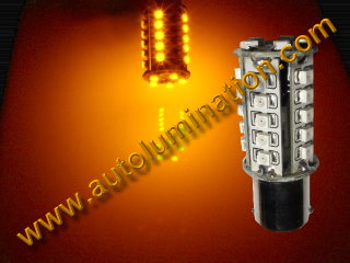

Gimli, if I may chime in on the turn signal lamps - From what I've seen, I'm going to guess that the 1156 lamp is a type P21W bulb, with a BA15s (bayonet, single contact) base. The rear turn signal lamp I just pulled out of its housing is the European PY21W amber bulb (made in France by Philips), which has a BAU15s (bayonet, single contact, skewered pin) base, more common in European autos. You're absolutely correct; 1156 lamps will not fit our rear turn signal application. (I've not laid an eyeball on the front bulbs; my hands and arms are over five years old!) Luckily, if one needs or desires to change the bulb, there are plenty of colored glass, stealth glass and LED bulbs out there available with this curious BAU15s base. I guess simply changing the electrical fitting to one that accommodates the more common 1156 lamp would also work, which would open things up to a much wider variety of lamp manufacturers, styles, colors, etc.
Yep, that PY21w bulb looks just like the one I pulled out of the rear blinker. 7507 seems to be the North-American code for that type of bulb, which may make the front ones 7225, the dual-contact equivalent (unconfirmed).
Unfortunately I haven't found any retailer that sells good LED replacements for those formats.
It looks as though our friends over at Autolimination have a few. This one is their 7507 PY21W Tower European Bulb.
I'm hesitant to order these since I'm unsure whether these LEDs (and others like them) would be prone to line load issues when using them to replace incandescent bulbs. I do want to replace the OEM bulbs though; the "fried egg" look just doesn't seem fitting for the Genesis.

Now I tried the 1157 LED bulbs I got a while ago for the front blinkers and they work very well. They are bright (maybe a bit brighter than stock but not much) but not blinding and have a very nice, deep, amber colour. Unfortunately they do trigger the "burnt bulb" high-flashing cycle so I didn't keep them in. We'll have to see if there is a blinker relay that can be changed to fix that or if we're stuck with using load resistors to simulate a normal bulb, which I will not do. I used load resistors on my previous car and they're a pain in the bottom to get right and can represent a fire hazard. They do get extremely hot.

I must admit I tried the V-LEDS.com bulbs that Gimli tried,
("Now I tried the 1157 LED bulbs I got a while ago for the front blinkers and they work very well. They are bright (maybe a bit brighter than stock but not much) but not blinding and have a very nice, deep, amber colour.")
and found they were no where near as bright as stock. Maybe at night on a lampless street, but certainly not in daylight. They are barely noticeable.
I have also tried 60-LED towers for the rear turn signals (at $40 each), even another 'high-power' variant, and still quite pitiful compared to stock. IMHO, it's going to be a while before LEDs are as bright as incandescents regardless of price. AM disappointed, but I'll take safety over 'cool' any day....
