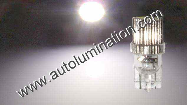

Try the following:
Outfitted with the latest Super High-Flux low profile Leds
Designed especially for gauges, and applications requiring a large uniform field of bright light
Note: These have the all metal heat sinks for constant-on applications to reduce heat related failures
Only 9mm diameter x 24mm overall
Order 194 Superstar Bulbs (shown above): $6.99 ea.
