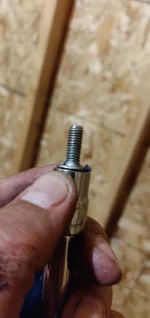

Was working on the car last night for 4 hours and had to throw in the towel for the night. The turbo is mounted; but, so far I've been unable to line up the turbo oil drain pipe's holes with the threads on the bottom of the turbo.
This is very frustrating and difficult. Thing is, once I get both bolts in, all while balancing the little gasket in-between the pipe and turbo, then the rest is easy. But right now it feels impossible.
If I had a RWD car this would be much easier. But, the way I see it is, if I was able to get the bolts out, I can therefore get the back in.
I even tried sanding the tip of the bolt to make the end more narrow, hoping it would slide into the bolt hole easier....
...I even sanded it more that what you see above to give it more of a slightly pointed end, but I'm still not able to get the threads started.
Perhaps I will have to loosen the turbo from the block, and see if I can shift it onto the turbo oil drain line. Problem with this is it's nearly impossible to keep the gasket lined up in-between the two.
Sigh. This is really hard. But I gotta keep going. Will try again after I can some sleep.
Got in touch with the Stinger guy who did his turbos. He explained to me to keep the turbo unbolted from the block so I can move it around, then carefully line up the bolt holes. I may need a second set of hands to do it, but at least there is hope!

Todd. Have you tried a little gasket adhesive that way you stick it on the turbo and the gasket won’t move
