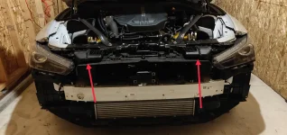

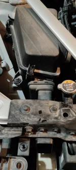

Just wanted to note another option that's free. A fellow on the Stinger forum removed the OEM intake's 90 degree elbow just behind the bumper. He measured the restriction of that piece to be 5 inches of vacuum. The total vacuum of the intake is 9 inches. So removal drops the entire intake to just 4 inches of vacuum, which means less restriction, thus more flow. Also perfectly safe from rain/water and a straight shot into the intake box. Lastly, still direct cold air.
I did it and feel better throttle response and more mid range grunt. I also like that it stays quiet.
And to further clarify, these are how the elbows look before removal...
You're basically eliminating 3 and a half 90° bends from the intake tract by removing them. Definitely a bottleneck.
Hard to argue with free power.

But yeah, I think it's a good option, especially for those that don't want more noise

So you have to take the bumper off to do this? How difficult would you say the whole procedure is?

The bumper needs to come off, yes. I thought it would be more difficult than it was but I took my time to understand how to clip it in and out at the fenders etc and it wasn't bad at all. I would estimate about and hour or so for the whole job.
