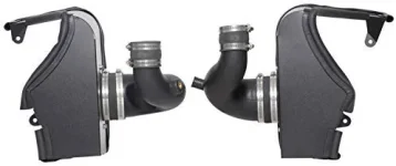

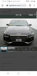

Hey guys,
Just ordered the AEM Intake off amazon.
I Was really going back and forth between the AP, K&N and the AEM. I really wanted the AP , but for the price, i decided to go with the AEM. Plus i preferred the red color on the cones as oppose to the blue.
I own the G70 3.3 Sport Rear Wheel drive and live in Northern Virginia
Enjoy the attachments of Intake and vehicle.

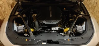

I like the AEM intake, for the price it's a pretty decent product. Just keep in mind that you need to either trim the passenger side diverter valve hose, or just get a straight replacement hose (that's what I did). In addition to this, the driver's side heat shield gets in the way of the OBDII diagnostic plug. You can move the plug, or trim the heat shield (i moved my plug).
I upgraded my filters, also added some heat reflective tape. I think it looks pretty dang good.

Oh i read your post, definitely bought that valve. Oh your the man. Thanks for the heads up. That gold on your looks phenomenal. Do they have one in red?

Nice! You got me curious...I started looking for red heat reflective tape, but I can't find any. I did, however, find some red reflective tape - but it looks like it's designed for more construction/industrial use, not to reflect heat radiation.
