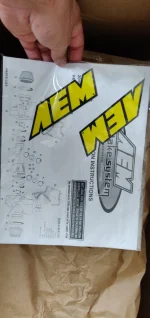

I ordered an AEM intake over 3 weeks ago, still don't have it. Evidently they're on backorder, and don't have a ship date until early next month. Very frustrated.
Checked other suppliers too, same story, except for vivid - but only AFTER ordering they're saying it's actually not in stock, and I'm stuck waiting just like before.
Just ordered mine today from Jegs. They say shipped directly from manufacturer on 08/28. We will see
Update. Jegs says delivered 09/08
