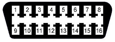

Otherwise if you plan on doing the wiring below which I will be doing for my Escort smartcord, you can tap into the OBD Connector wiring for ignition and ground.
OBD Ignition - Pin 3 / Blue/Orange
OBD Ground - Pin 4 / Black/Orange or Black
PIN VIEW SIDE / NOT WIRE SIDE
