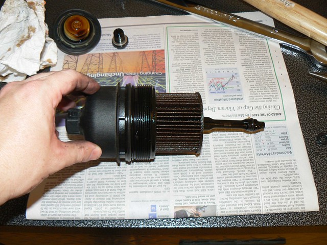

I have changed oil many times but have one question on the top mounted filter on my 2011.
Is it obvious where the little "o" ring goes?
The very good write up says at the bottom of the stick.
Can anyone show me a picture or explain where it is located
many thanks

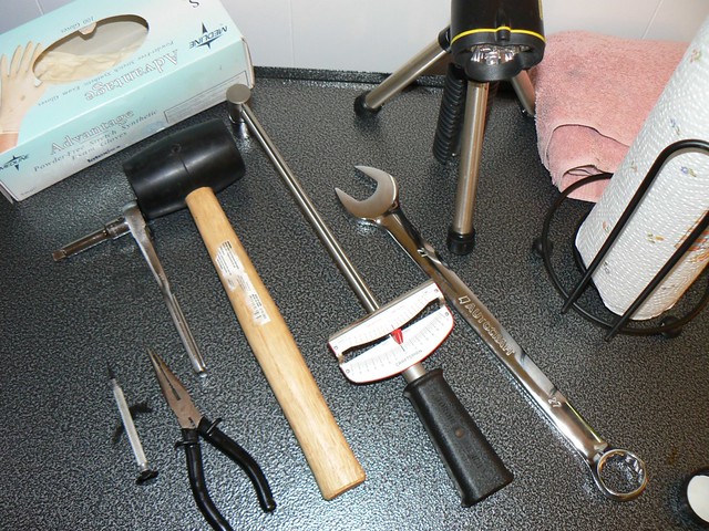

What you'll need:
• New Hyundai oil filter kit:
• Ramps or a jack and jack stands
• 6 quarts of oil - 5W-30 or 5W-20
• Oil pan that can hold at least 6 qt
• Funnel
• 17mm socket and driver ratchet
• 27mm box/crescent wrench or socket
• Size #0-1 flathead screwdriver (maybe a hole punch will work, or other small prying tool)
• Torque wrench(s) that can handle 18-33 lb ft
• Rubber mallet
• Needle nose pliers
• Rubber gloves to keep your hands clean
• Some shop rags
• Newspaper or other large coverage material to catch any errant oil
• Flashlight
• Clear work surface

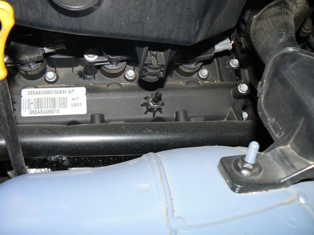

Pull of the engine cover. It is secured with four plug-connectors. Stand on the right or left and simply tug upwards and they will pop off. Place the cover someplace out of the way. Depending on how you set up, you may want to put down a ground cover now to catch any errant oil.
Here's the bottom of the engine cover - note the four plug connectors:

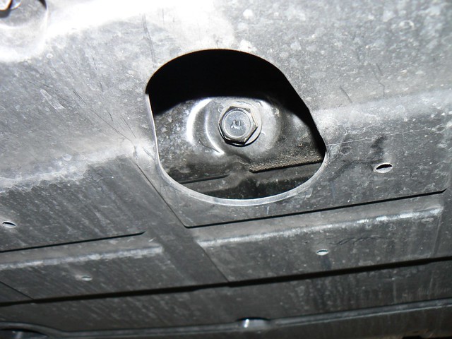

Take the 17mm socket, rubber mallet, and your drain pan and slide under the car. The bottom of the engine bay is covered with a plastic undertray but dead center is the opening for the oil bolt.
Apply the 17mm socket and use the rubber mallet to knock it loose. Once it is loose, place the oil pan under the drain bolt so its leading edge is directly under the bolt and the rest of the pan is toward the rear of the car. Once oil starts flowing it will initially arc out of the pan before it starts to drip straight down, so you want to catch that initial surge.
Continue to unscrew the oil drain bolt by hand until its completely off - try to keep it from dropping into the oil drain pan as it comes loose. If you drop it in, try and grab it quickly if the oil is not too hot. You'll want it so you can replace the crush washer.

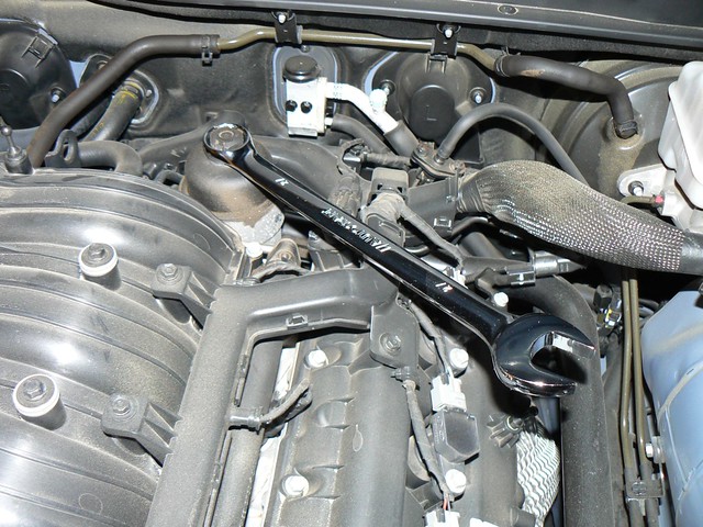

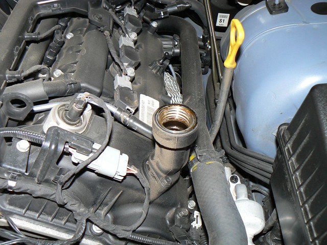

The 3.8 V6's oil filter resides on the back of the engine by the firewall, but other than that, its easy to get to.
Take the 27mm wrench or socket and rubber mallet and knock the cover loose. Once loose, continue to unscrew the cover. It took me around 16-17 1/4 turns to get it so I could loosen it by hand.
Once the cover is free, carefully lift it up and out of the engine. Note it will be oily so you may want a shop rag to catch any drip. Place the cartridge on your work surface.

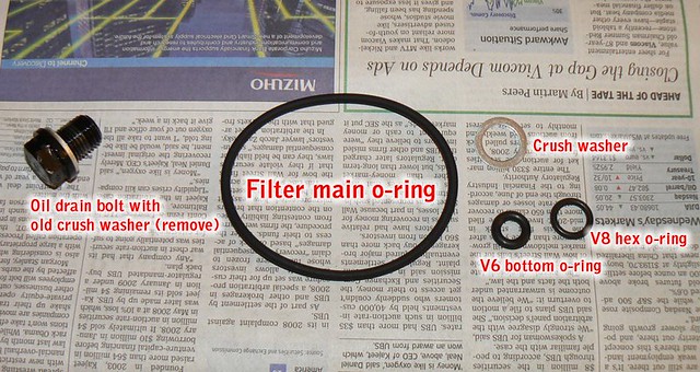

Open your new filter and makes sure all the parts are accounted for. The Hyundai filter comes with a filter, crush washer, and three o-rings of different sizes. For the V6, we don't need the V8 o-ring.
Remove the old filter from the cartridge by tugging on it. Its only held on by friction, but being covered in oil, it can be slick. Make sure the old filter and new filter look identical and have the same part numbers. Note that Hyundai has changed the part number a few times in the past.
If your new filter looks good, proceed by removing the rubber o-rings from the cartridge. There is a large o-ring near the top of the cartridge and a small o-ring at the bottom of the cartridge stem.
The top ring is easy to replace but the bottom ring can be tricky. The top ring you can pretty much remove and replace by hand. Use the #0 screwdriver, needle nose pliers or small prying tool to pop it off and carefully install the replacement. Dip your finger into your new oil and apply a coat to the two o-rings. This will keep them from binding to the engine.
Now remove the old crush washer from the drain bolt. You might need the #0 screwdriver here as well to pop it loose. Place the new crush washer on the bolt.
Pop the new filter into the cartridge. Push it firmly up so it pops in. If its not on enough, the cartridge will not screw back into the engine.
Place the cartridge with the new filter back into the engine. Hand tighten, then screw down until seated. Torque it to 18.4 lb ft.

No responses, but I have figured out where this little o ring goes
Where does it go? When I got the housing out, only the large o-ring was present. I am assuming previous shop didn't bother putting the small o-ring on. I pushed the smaller o-ring past the nub as far back as I could before reading the prongs. Was this correct?
