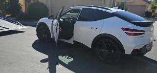

Anyone have their rear axles snap before they got around to do the recall? Yep My right one let go last week. She has my axles on order so they can install as soon as they arrive. Let me say my car is as clean as it's ever been as been detailing it in garage since.

Wow, so can you tell us what the circumstances were when this broke? Speed? How did the car react? Any ancillary damage to the car?
Well axles arrived to dealer today so I had car towed there this morning. Hope they can get them swapped out today

Actually was accelerating modestly as I turned right and snap grind grind grind grind. I made it to my destination a block away and made sure no fluid was leaking and nope. It actually does drive but it grinds awefullly when starting from stop or applying power in corner or coming to a stop as the axle keep spinnning while car is stopped. Now bear in mind I drift this car often so I was not the gentlest on the axles to begin with but for sure that recall is real.
