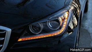

Here is an animated gif of what the signal looks like:
http://makeagif.com/i/QeBocO
QeBocO

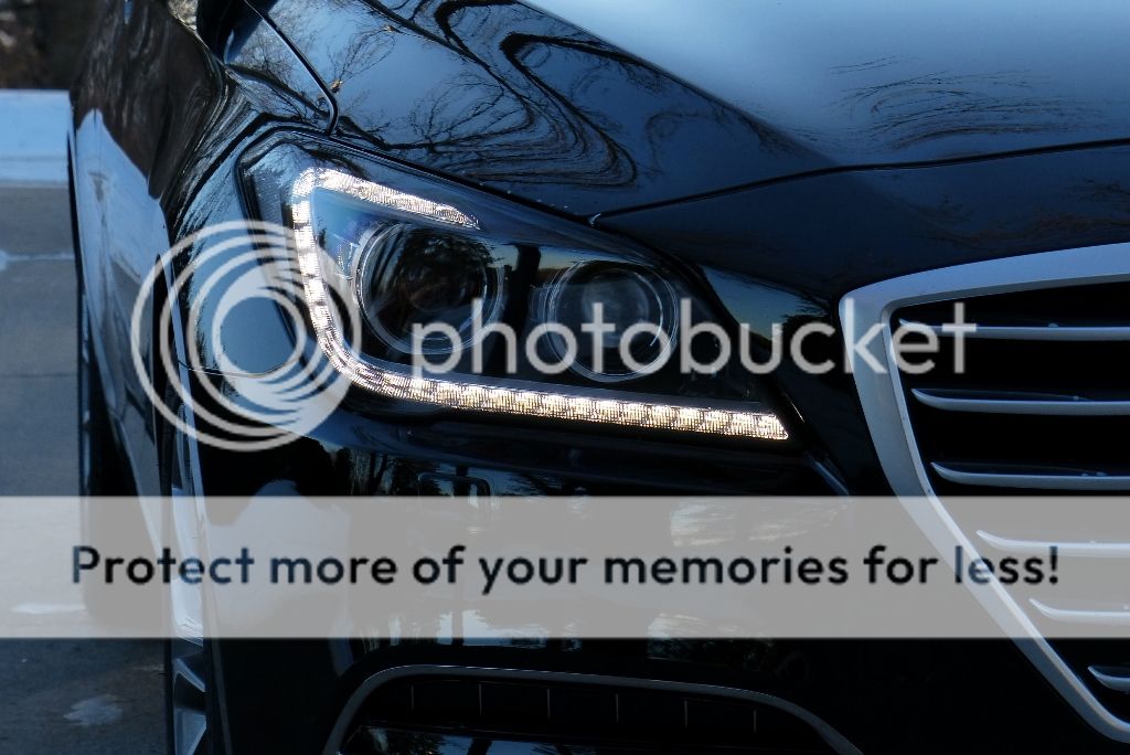

With lights off

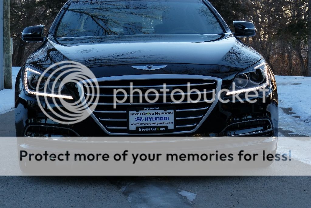

With DRL on
With DRL on

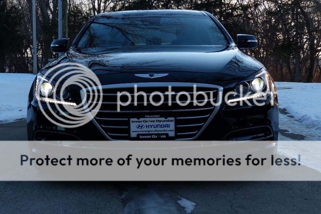

With low beams on

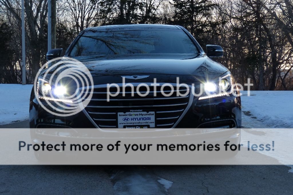

With high beams on
