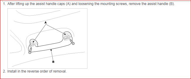

Actually, I drove it around with my wife tonight to better isolate the sound and found that it goes away completely if I pull down the spring-loaded grab handle over the drivers door. I tried it multiple times and it silenced it every time - so it appears the culprit is something loose in there. I'm going to take it off and reinstall tomorrow. Hopefully, that will solve it, but glad it appears to not be the pano roof itself (fingers crossed).

OK - so I opened the covers and checked the 2 screws that hold the grab handle on - but they were not at all loose as I had suspected they might be. I tightened both a little more, being careful not to strip the holes.
Unfortunately, this did nothing and the rattle was as bad as ever. So I decided to just take the handle off completely. I did that and replaced the screws (so I would not lose them) - lo and behold: the rattle is completely gone!!! I took the car out on a few errands and drove for almost an hour. What a difference to not have a near constant rattle in my ear when driving this car!
So the rattle is coming from the grab handle itself. In looking at handle more closely, one of the hinges is spring loaded and the other is not. The one that is not has a lot of play in it and this must be causing the annoying rattle.
Amazing (and frustrating) that a stupid little item like this (that I would never even use anyhow) has been the bane of my G2 driving experience. I'll be leaving the handle off for now and asking the dealer to order me a new one.
