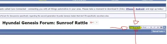

lol Bro why you so angry? Kind of a strong reaction. Anyways, I already have a case open with HMA, who has sent two levels of reps to look at the car, and now they are sending a Hyundai engineer. They have already told me it is a known issue with most likely no fix. I have already talked with the dealer and Hyundai extensively. I drove a loaner for 3 weeks, another genesis, which started the same noises. I have a case with the BBB open already. I am not just starting this journey. I am not sure where you are getting 20 pages, take a peak at my attachment. You may find the number 39 on there. :D
