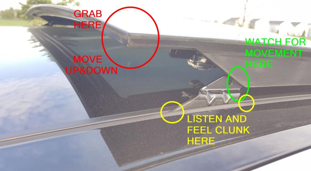

Back in April I posted a message in this thread when my rattle had progressed to the point of being too much. I included the picture below as a way to help identify where the rattle and clunk sound comes from.
Unfortunately over the course of the summer, my rattle has been slowly coming back. It is not as bad as it was, but it is heading that direction. One thing I found I could do to eliminate it is once the roof was fully open - to close it about 1 inch then stop it. That seems to keep the rattle down quite a bit. But I am also starting to get some creaks and ticks here and there as well when closed. I will most likely have to bring it back again by the end of the year.
Anyhow - just posting this pic to help people see and understand where the issue seems to be at.
