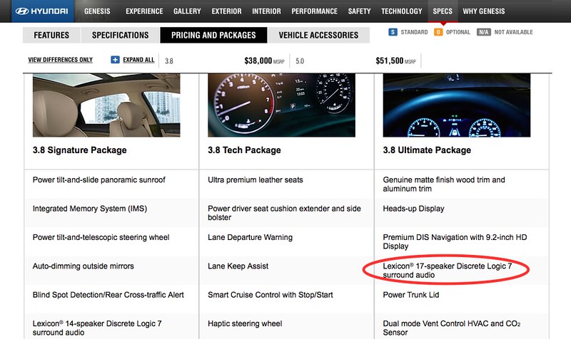

In the USA, the 3.8 Ultimate has the 17 speaker system!
3.8 Ultimate Package has the 17-speaker Lexicon!
Straight from Hyundaiusa.com
Re: 3.8 Ultimate Package has the 17-speaker Lexicon!
