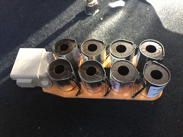

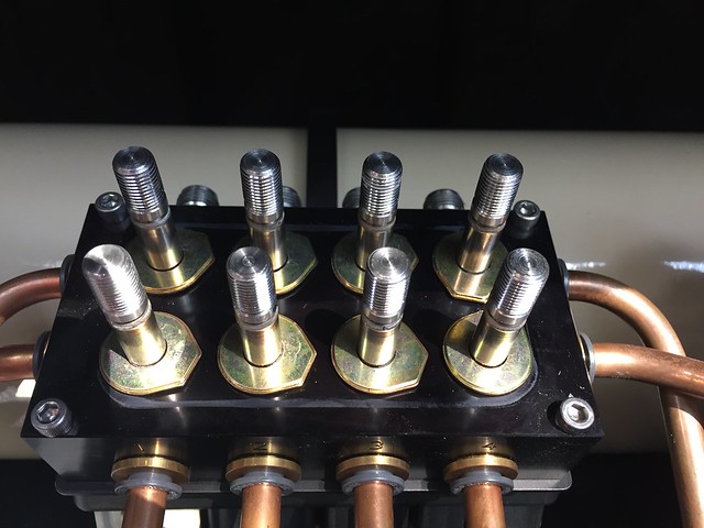

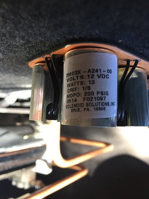

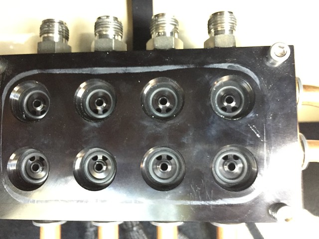

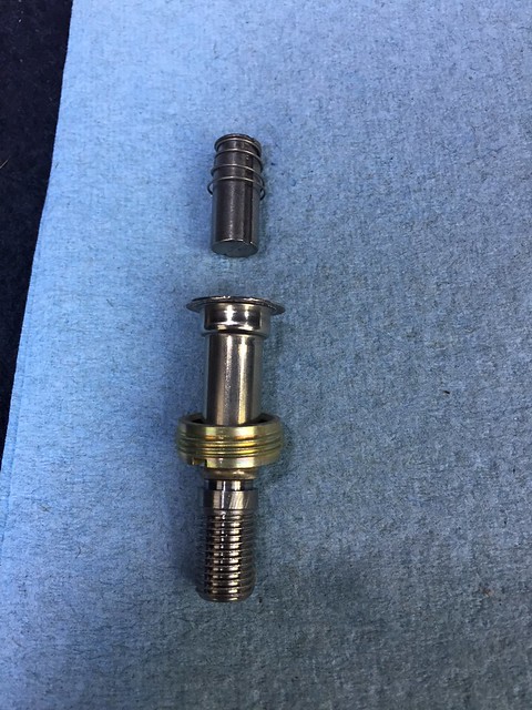

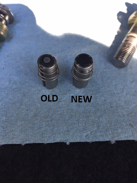

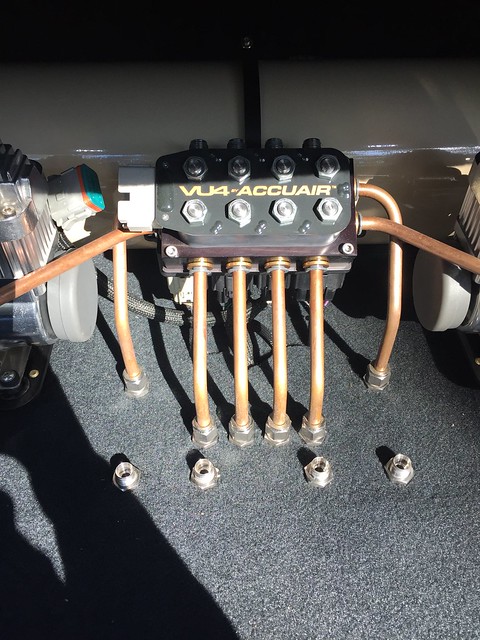

Performed a rebuild on my Accuair VU4 manifold this week after having problems with the passenger front corner losing 20-25lbs of air overnight. Checked all my connections for leaks before reaching out to Accuair. You could either send it in for a rebuild, get a $100 off the new VX4 manifold, or get a rebuild kit for free. Opted for the rebuild kit which consisted of 8 poppets with springs. Super easy to swap out even with my complicated hardline setup and took about an hour. Only had to remove four of my lines and was able to rebuild it without removing the manifold from the car. Also put my wheels back on my car which haven't been on for the past 9 months or so. Pics below.

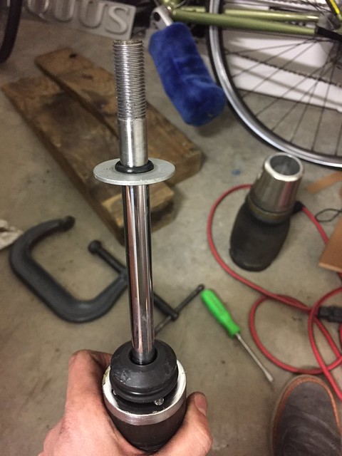

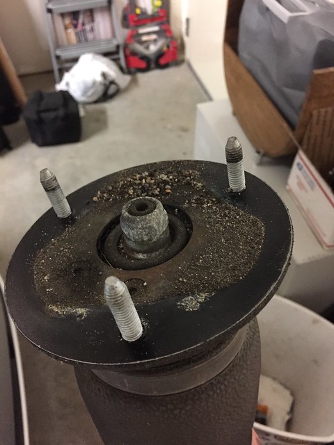

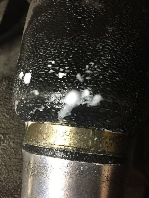

Turns out it was an airbag issue causing the air pressure loss over night. The leaking was worse after my car got shipped to California. Upon closer inspection I found pinhole leaks in the side of the passenger front airbag, driver side had no issues. Both are being replaced with double bellow bags once the correct parts show up. Airtekk sent me the wrong size and pitch twice. Now currently waiting on a set from AirForceSuspension which I'm losing hope in as well. Once installed my car will be for sale. Pics below. Gives a good idea on how these components have held up over the past 4.5 years.

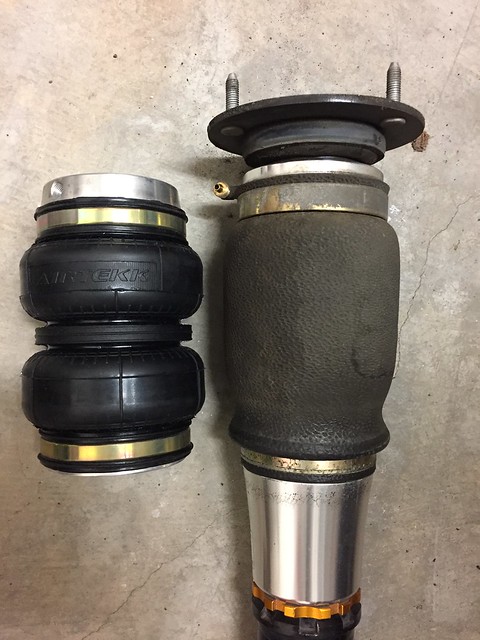

Finally got my replacement parts from Air Force Suspension last week. The double bellows from Air Force and Airtekk are identical, except Airtekk brands the bag itself. Made the strut height the same as when the sleeve bags were installed. Running 86-90 in the fronts now and I find the ride to be more bouncy. Prefer the ride quality of the sleeve bags over the bellows with current strut length. If I was keeping the car I would reduce the overall height of the strut in order to run higher pressure.
Airtekk Left AirForce on the right
