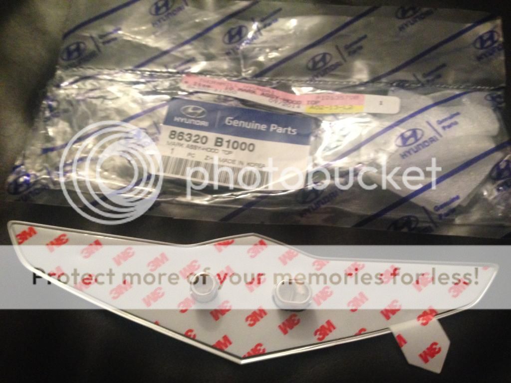

So I picked up my 2015 Genesis Sedan today and the dealership threw in the rear trunk emblem but didn't want to take a chance installing it themselves. Based on what I have read in this post did I get one that is not going to fit even though the pins look like a perfect fit.
Was planning on the install this weekend.
That part number is different than the one shown in a pic at the beginning of this thread. I wonder if they gave you the front hood wing emblem (it seems to say "Hood" on the part)? The rear wings are not an OEM part for USA Genesis, but are OEM in Korea, so they are usually imported by vendors who by them from Korean dealers and sell them on eBay, etc (some USA dealers get them from eBay vendors also).
I guess if the front emblem fits OK on the trunk, and you like it, then no problem. Make sure it lays flat (before you expose the tape), as the front wings for 2009-2014 had a slight curve to match the curve in the hood. Even if it is not perfectly flat, maybe it is flat enough.
